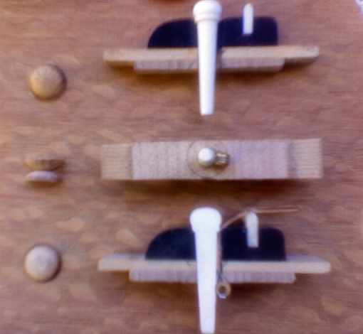

PostPosted: Sat Sep 22, 2007 7:55 am
Posts: 2060

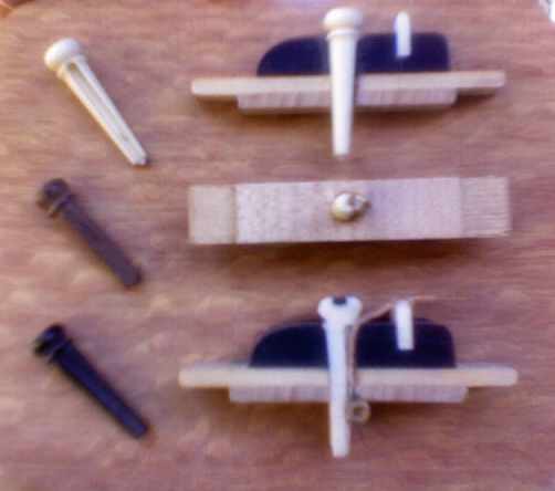

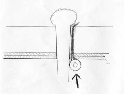

Slotted pins
If the slots are deep enough, most of the force is directly upward against the
bridge plate.

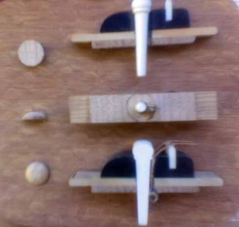

PostPosted: Sat Sep 22, 2007 7:58 am
Posts: 2060
Edit: above I obviously meant to say unslotted. Those are unslotted.

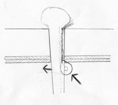

Here's the slotted pins
Here there is a good deal of force prying perpendicular to the bridge pin,
and the ball end is trying to wiggle it's way in to the hole that it's sitting on
the edge of.

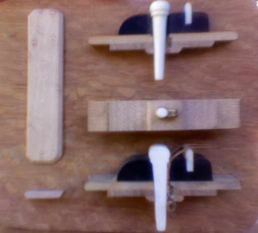

PostPosted: Sat Sep 22, 2007 8:00 am
Posts: 2060

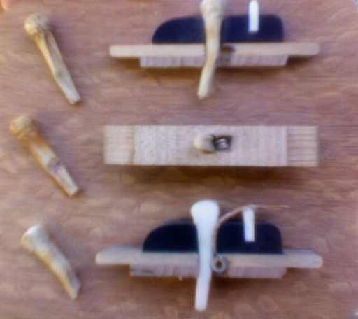

Here's slotted pins after 10-20 years, depending on your luck.
Here's 20-30 years.

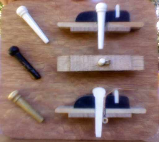

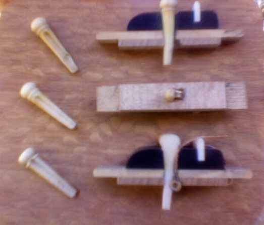

PostPosted: Sat Sep 22, 2007 8:02 am
Posts: 2060
And here's more really bad shots of various repair methods.
PostPosted: Sat Sep 22, 2007 8:08 am
Posts: 2060
When I get a real camera again I'll try to post a better pictorial here. These
are demonstration boards I made so I can explain the repairs I'll be doing
to the owner of nearly every guitar that's 20-70 years old (unless it's
already been done).
It's rare however that this needs to be done to guitars older than 70
years. That's because back then in the days before injection molded
plastics, manufacturers used unslotted pins and slotted the bridge. These
instruments are usually still just fine.
Slotted pins happened out of convenience, and the problems didn't start
appearing until they had already come in to standard use for 30 years. At
this point it was so standard that manufacturers weren't about to switch
back. More builders today however are going back to this style, for good
reason.

And another thought is where the load is placed against the plate. With
slotted pins it's right up at the corner where it will gradually chew away at it.
With the slotted bridge and unslotted pin, the load bearing area will be well
away from the edge.

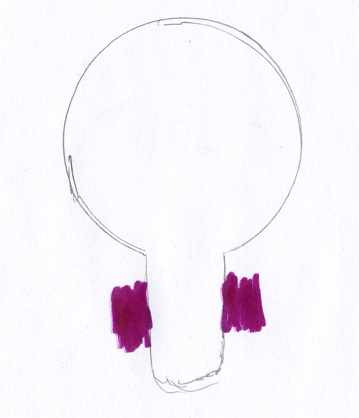

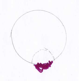

I was looking back at your drawings Todd (much better than mine btw)
and see a few changes that would help demonstrate my point, and may
even help explain some of our difference thoughts.
First, in the slotted pins notice that the ball end will almost always work a
corner in to the slot, rather than bumping up against the outer diameter
as in your drawing.
[IMG]../forum/useruploads/DavidCollins/2007-09-22_201248_1.jpg[/
IMG]
Look closely at the really bad photo of the bottom of the plate on the top
left. Notice that the one side of the ball end is more than half of it's
diameter over the edge of the hole, if that makes sense. This means that
it is not only the angle the string pulls at the ball end, but the ball end
itself is actually acting as a wedge with the upward pull of the string.
Every small bit the hole wears or the pin dents and bends means that the
ball end moving slightly further in. The ball end them makes contact with
the hole's edge at a steeper angle, or tangent to the circle, and becomes
and even more effective wedge to crush wood and bend the pins.
